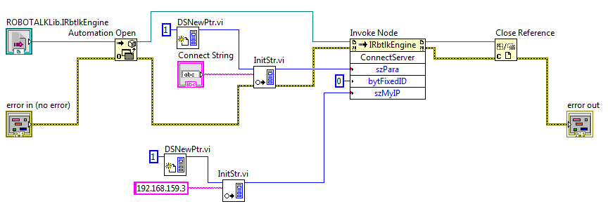

I have a COM DLL I am trying to use from LV2013 32 bit. I have managed to get as far as the ActiveX "Automation Open" and an invoke node. This gets me a parameter list which looks right (input and outputs) but I'm not sure the actual datatypes are correct.
I have the DLL, a header file and an IDL file and 2 different bits of documentation (not all of which agrees).
I am trying initially to just connect to the server using the code below (see test Server Copnnect via dll.png)
This fails telling me I have incorrect input parameters.

szPara should be a pointer which should be Unlt32 for a 32 bit program (which this is) yet the data type reports itself as an I8 (8 bit integer). the szPara should contain connection txt such as "eth:10.10.10.10:5000".
I tried to create a string pointer to the data but it doesn't work. I tried typecasting to the I8 but that kills my data and I wind up passing zero to the dll. I tried it then as above but wind up with coercion dots. Do I need to convert my pointer into multiple bytes? (Not sure how to do this).

Couldn't get image in previous post so here it is

Something looks pretty broken here. Are you sure you're opening the correct ActiveX object? I could understand if the strings were being passed as arrays of chars (8-bit values) but accepting only a scalar seems weird. Can you provide a link to documentation, and ideally to the actual library you're using, if it's public?

You can't allocate a pointer with one byte and then try to copy in a string which is more than one character. That surely will crash. LabVIEW has no way of resizing pointers, so you have to allocate them right from the start or better not at all and leave pointer acrobatics to the guy who knows best, which is the C compiler. Smiley LOL
However from the picture alone it is not clear if szParam is recognized by LabVIEW to be a pointer. It could be just as well be a 8 bit value. It would seem that the guy who wrote that component surely has had a bad day when creating the type library. The type library certainly should define szParam and szOption as strings rather than a skalar pointed to reference and then LabVIEW would properly recignize that these parameters are strings and show them as such in the diagram node.
The discrepancy between the names of the parameters between what your documentation says and what LabVIEW recognizes is another hint that you might in fact be barking up the wrong tree (in other words looking at the wrong Active X Object in that Automation Server DLL).

I am interested in how I might have picked up the wrong object, can anyone give me some more details on that. When i select the method in LabVIEW I get an option to show all methods not just the ones I can connect to and it lists 2 x ConnectServer
IRbtlkEngine::ConnectServer
and
I have chosen both but it always winds up as the same IRbtlkEngine::ConnectServer (which I am guessing is the public interface).

A list of function names in the DLL is as useful to diagnose the issue at hand as would be a a list of random characters to understand a language: Niente, Nada!
It's even worse than having just a header file for a standard C DLL, which at least can tell a little about the parameters but the C syntax is notoriously inadequate to describe the actual API in a disambigous way.
In there "char* name" can be a string, a single character passed by reference or a byte array. "void *name" is even more ambigious as it could be basically anything! That is why Microsoft created ActiveX with a typelibrary interface that describes the functions in much more detail and this typelibrary is what LabVIEW (and Visual Basic and other "Visual" languages) accesses to build the diagram nodes that access the methods and properties of an ActiveX object. If this type library is wrong there is nothing you can do in LabVIEW to make it work anyways except writing a C++ wrapper that access the ActiveX object and translates them to a correct ActiveX interface. The reason is that VisualC does allow to access the typelibrary but as a true C descendent also allows to do everything the hard way by programming every detail explicitedly.
