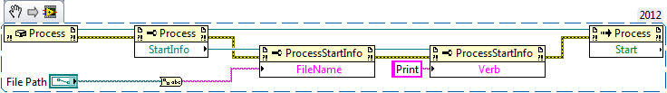

.NET should be able to handle this one way or another. The snippet was adapted from https://stackoverflow.com/questions/19662130/print-image-using-windows-print-image-dialog

A million kudos to you sir (in the form of one) if you are going to NI Week I'll buy you a beer to thank you.

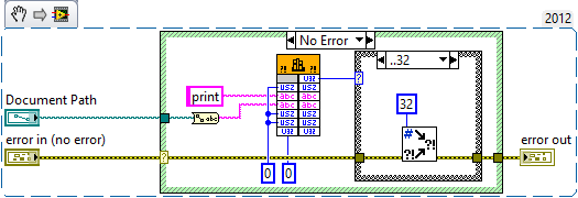

This works too Smiley Happy (only for files which have a Print menu in the Explorer popup menu, but that's the same for the .Net method, and in fact .Net calls exactly this function internally, well most likely ShellExecuteExW() but that is about the same).
