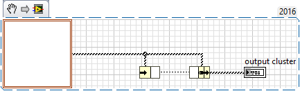

Intaris and Altenbach already mentioned the possible compiler optimizer limitations due to code complexity.
This code demonstrates the "Magic Pattern,"  that LabVIEW 2010 and later MAY optimize to operate in-place with a minor performance improvement over using an IPE
in 2009 that would need a IPE to operate in-place. in 8.6 and earlier the IPE is unavailable.
OK that handles the IPE question but, I am guessing what you really meant to ask is "How do I fix my Real-Time FM generation vi so that the output is contiguous?"
Without seeing your data cluster and the FM signal generation vi that uses it we can only give general advice.  So, let's see some code.
