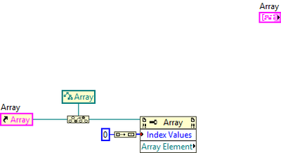

Does anyone know if it's possible to get the number of elements in an array from a reference to an array?
Either I have found that something that has completely stumped me (or I'm missing something really obvious), or it isn't possible.
The code snippet below shows a small test harness I've setup. I have a reference to an array of clusters, I'm casting to a generic array, to simulate handling different array content types, and then I'm indexing an array element (referencing this post https://forums.ni.com/t5/LabVIEW/Reference-to-array-element/td-p/737720?profile.language=en).
However, for what I'm trying to do, I need to know the size of the array, and at present I can't see from the array properties available that it is possible, and other techniques like seeing if the property node throws an error for an out of bounds index doesn't work.

If you cast the array ref to a more generic as show in the picture, it gets a bit more difficult.
There is an OpenG VI to do it, I had a look inside and my eyes started to bleed.

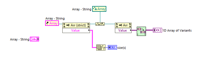

If y'all don't want to use the scary OpenG VI, you can cast the array value to an array of variants, then get the size of that array.
Message 7 of 13
(5,694 Views)
The power and flexibility of variants never ceases to amaze me! It's a topic I really need to learn an awful lot more about. That's really useful. Thanks Darren.
