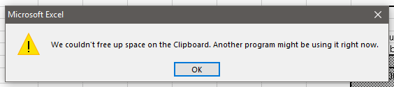

This all works fine, except I get the following dialogue when running the macros through Labview:
"We couldn't free up space on the Clipboard. Another program might be using it right now"
The dialogue pops up intermittently. I ran one particular macro several times through Labview. Sometimes I get the dialogue pop up a few times during one call, sometimes not at all. The pop ups are not acceptable as the system needs to be automated without the need for an operator.
Has anyone else experienced a problem similar to this? If so, is there anyway to just bypass the dialogue?

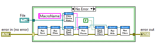

I will end with a screenshot of my block diagram for my simple Run Macro with Labview utility.
Thanks for your time

Ah, just tried this approach but still get the pop up. I see the dialogue in the middle of a macro run so I guess clearing at the end doesn't help.

Great suggestion. I added a 2 second wait between copy and paste iterations. I did not get the dialogue after running the macro ~10 times. I did get a different dialogue stating "Cannot open clipboard" but it only happened once.
So macro is much more stable. Just need to verify integrity of data.
Looks like the problem was actually happening in the "Excel 4.0 Macro" level and not VB and Labview calling it. Even though functions are called sequentially, clipboard falls behind?
For now I will implement the delay in all the macros and do more intensive testing.
