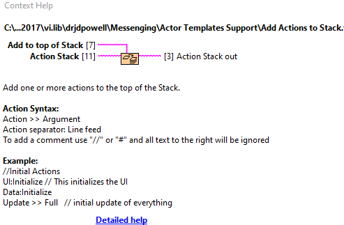

The "Action Stack" is actually the same as JKI's "State Queue" (I stole it from them).  One of my "Do's and Don'ts" for using the JKI was to always place on the front off the "Queue", so I redid the API to favour Stack use.  The difference comes up only when one adds actions to a non-empty Stack/Queue (which doesn't happen in my example, but uses this subVI:
