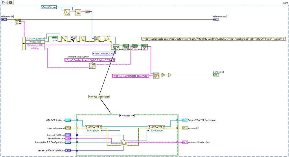

Hi all,
This is a bit of a long shot, but is anyone else calling a secure WebSocket endpoint from LabVIEW and had it break recently? It's suspiciously close to the date of Let's Encrypts old cert expiry date..
I have some code I have been working on for a few months, and up until I picked it up again this week it had been working fine.  It's now failing to connect to the WebSocket address, with an error message indicating that a certificate is out of date
I have checked the endpoint using wscat, which is a command line tool that's available on npm [https://www.npmjs.com/package/wscat] - the endpoint still works fine, I am able to manually authenticate and send it data.  So it looks a lot like the problem is in the LabVIEW code
This uses MediaMongrel's excellent WebSockets toolkit from https://github.com/MediaMongrels-Ltd/LabVIEW-Secure-WebSockets-Addon
I've attached what I think is the important part of where the error is occurring.  The specific error is -715047 at Start TLS
I've exported the DER from the current ISRG Root X1 cert in Win10 and tried inserting that into the TLS configuration but to no avail - this part is new, the built-in certificate handling was working fine before

I have had the exact same problem - previously working code involving the HTTPS & Secure Websocket clients stopped working when I went back to it this month. If it helps anyone:
To fix the HTTPS client problem I simply replaced the LabVIEW ca-bundle.crt located in "C:\Program Files (x86)\National Instruments\Shared\nicurl" with the latest CA certificates extracted from Mozilla from the curl website (best to backup the original LabVIEW file though!). This, however, did not solve the secure Websocket client issue, which continued to throw the -715047 error at Start TLS.
To fix the secure Websocket client issue I had to set the "load OS trusted CAs?" to false in the "New TLS Configuraton" VI. I then loaded in the LabVIEW ca-bundle.crt certificates to memory & added them to the trusted certificates in the TLS configuration when initialising the SSL/TLS. I later found that disabling "load OS trusted CAs?" alone seems to be enough to get things going again.
Sean
(2,769 Views)
This is brilliant, thanks DrSean
My solution is basically what you have for your Web Service - the only difference being that I exported the ISRG Root X1 certificate from Window's certificate store and passed that into Add Trusted Certificate To TLS Configuration
The part I missed on the first try was that if you don't set load OS trusted CAs? to false in New TLS Configuration, passing in a valid certificate doesn't fix the problem
