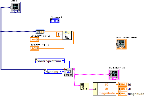

I have a problem with combining my spectrum circuit to my filter circuit. when i try to take the output of my spectrum to the input of my filter, it says they are different kinds of info. Is there anyway to combine the 2 circuit together? Here is my vi. I need help urgently! thanx!

I want it to create the spectrum than straight away use the spectrum value to filter away the noise in the waveform. Is it possible? Because the data coming out from the spectrum is a cluster or 3 element. How can i do the let the data run in my filter function? Need help plz! >.< thanx!

The output of the Power Spectrum and PSD.vi is actually an array of clusters.  First you need to use Index Array to one of the clusters. Your file only has one element in the array. Then Unbundle by Name gives you access to the elements of the cluster.  The Magnitude array is probably what you want to "filter."
How do you intend to identify the "noise" components of the spectrum? It is unusual to apply a time domain filter to frequency domain data. What are you trying to accomplish?

Thanx for the reply. What i am trying to acommplish is just like my vi shows. First i get my spectrum and from the spectrum i get the value for the bandpass filter. Now what i wan to do is to merge the 2 circuit together. But i am stuck on how to unbundle the array cluster. I tried to use the unbunde function but it cannot be unbundle this way. Can you do a demo for me? thanx!

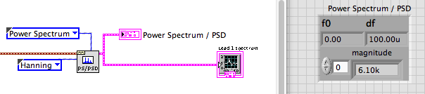

The images below show how you can unbundle the spectral data after indexing and how to display the numerical values of the PSD output.
Lynn
