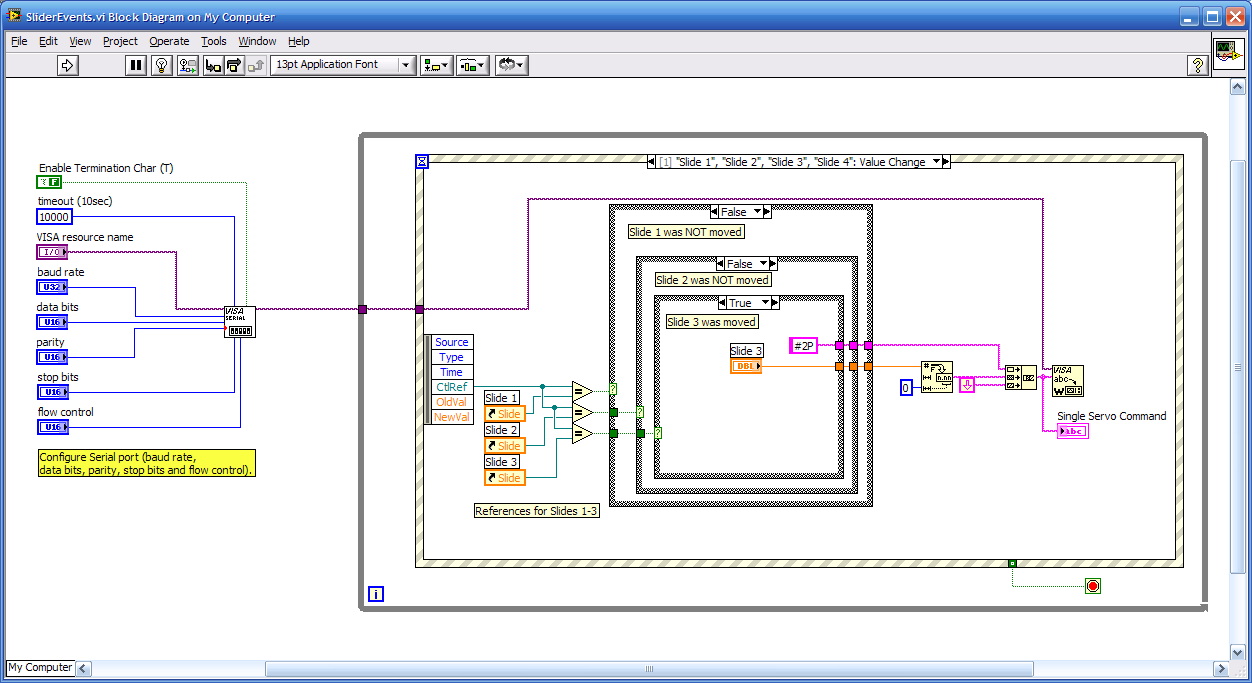

Hey Frank,
If all 4 of your servos are connected to the same COMM port, and are controlled separately by 4 different commands, then there is no need to keep opening and closing the port. Just open it at the beginning of your program, and close it when you exit the program.
Then, I would suggest opening the example "Top Level Application Using Events" as your starting point. Add your 4 sliders to one event, (you can have multiple controls for the same event). Create 4 "References" for the sliders, and compare them with the "ctlref" for that event. Use a case stucture to determine which slider was changed, and send the proper command.
I'll see if I can create an example of what I mean.
B-)
Message 4 of 8
(3,724 Views)
Here's what I mean...
However, it only sends one command at a time. You didn't say if your servo controller requires all 4 commands at once. If so, then you can remove the case structures and concatenate all 4 slider values into one string.

Hi B,
I have tried this code and works great!   This is exactly what I was looking for.  Thanks very much for your help! Smiley Wink
Frank
