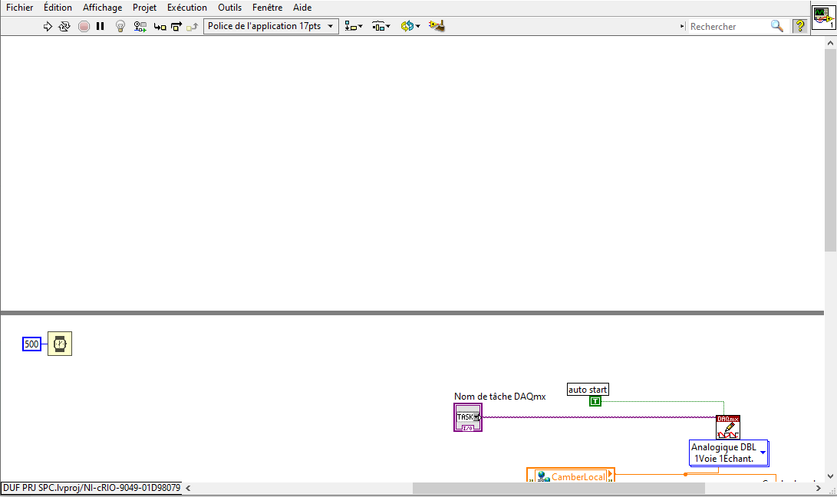

Hi GerdW,
I'm not able to find the selection box that you mentioned.
can you please help me finding it?
CV-ND
Message 5 of 8
(2,709 Views)
Hi CV,
I don't see any FPGA code in your image!?
Message 6 of 8
(2,635 Views)
If you are using DAQmx on a cRIO, you are not using the FPGA in a user-configurable way.  The code you have is on the RT side of the cRIO.
