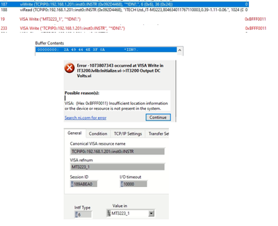

Here it is the trace, the upper one when I try from NI-MAX, the two errors are when trying from Labview. I did tried with shortened VISA reference and also direct TCPIP link (both returns the same error). The VISA Open works however (added a probe after visa open and the result is at the end of the screenshot so it seems it finds it ok, the issue appears with first VISA write which is a IDN query.

You have not released the resources the the VISA test panel is reserving.  No other application can get a session handle while the resources are reserved so you get an error that essentially means; "VISA cannot open a session to that resource from this application."
Close the VISA interactive test panel and try again.

It is closed. I did also retried with restarted system (without even opening that panel). Does not works.

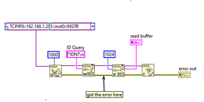

You haven't shown any code yet, so it is hard to say what you are doing in your LabVIEW setup.

That's exactly the reason I did made a simple test code (attached) which produces the same error.
I did tried with, without termination character etc. but the buffer in IO trace looks the same for VISA test panel and this dummy code:
