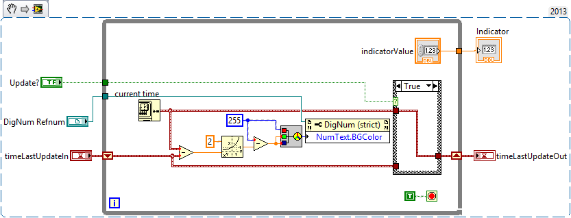

Not your exact VI as you posted, but using that method. The snippet below is called an Action Engine, it runs through the while loop exactly once. (Don't ask me about that "DigNum Refnum", the property node was supposed to be hooked up to the indicator.) Just wire the appropriate controls and indicators onto your subVI's connector pane.
You could also bundle your indicator and the last update time indicator as a cluster for output, and unbundle them as your first step in the subVI, then you wouldn't have to remember to pass two things to and from the subVI every time.

Sounds good, but you've lost me. So what you are showing now is the subVI. (The bundling remark I get.)
The best I've come up with so far is that you want me to to call this subVI, from the main loop of the parentVI, for all the indicators I have on the front panel of the parent? [by passing them as a reference?] But then the parentVI will have to check wether the value has been updated? Why not do that in the subVI?
BTW Would it be possible to attach your VI to this post? I'm using 2011 so I can't import your snippet as is.
