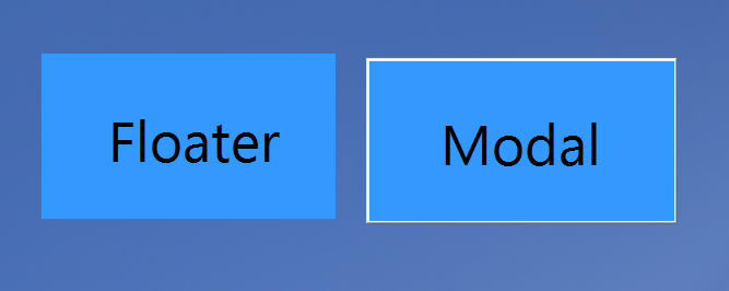

From memory so try it before you buy it.  If you make the window modal it will get that border, but if you make it floating then it should be borderless.  This is not last century, but last decade (LV9).
Message 8 of 16
(3,382 Views)
Just tried in (LV2012, Windows 7) and the border shows with all settings (default, modal, floating).
(If the FP is maximised to the screen, the border is outside the visible monitor area and thus not shown)
Message 9 of 16
(3,373 Views)
Weird.  LV12 + Windows 7.  Basically I chose Dialog for the window type, then customize to remove the title bar and select modal/floating.
