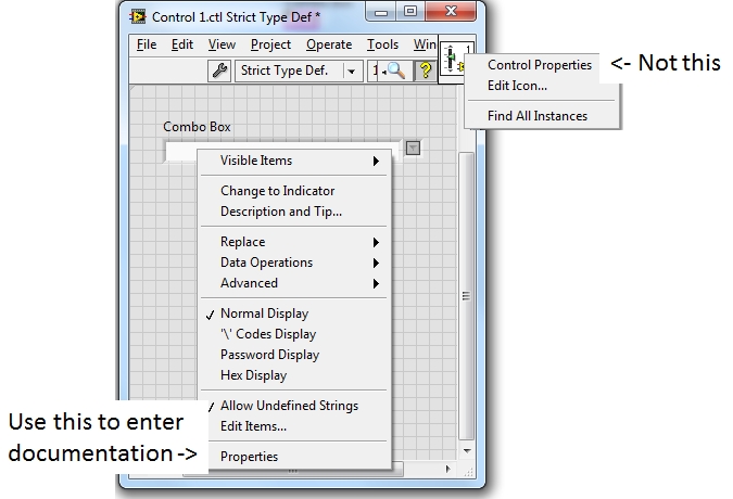

When you enter the documentation, do not do it using the icon of the typedef in the upper right corner of the control. Enter the documentation directly using the variable property in the typedef control. The documentation entered that way will show up in the variables created from the typedef.

No what I mean is when the control type def is open, enter the documentation using the properties of the control itself (the variable), not the control properties accessible through the icon in the top right corner of the control type def (see below).
Also, the documentation of any variable created from the typedef will be the documentation in the typedef at the time of the creation of the variable. If you want the to be able to change the documentation and have the documentations of all the previously created variables updated at the same time, you have to use a "Strict Type Def" instead of simply a "Type Def".

Thanks for your replies -
You are right, I was creating constants and the typedef documentation is not passed on, even when using "strict Type Def". If I change the constant to an input element, the documentation is passed on.

I took a brief tour of the options and unfortunately I didn't see an option to change this behavior.  😞

Constants created from type defs are allways non-strict.
