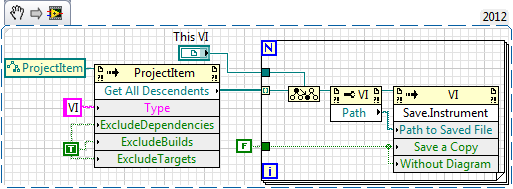

Found this on LAVA
Edit: woops, jeff beat me to a solution

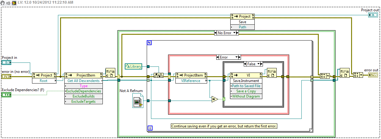

The Lava Link-  I was mobile last night and couln't look into this
Seams to be open
As too the LAVA Code working slowly.  I would guess that a "Defer FP Updates" might help a bit around this code since this VI is going to hog the UI Thread.
Migrating the Loop invarient constant "Not a Refnum" outside the case in the loop may help too. (Just guessing with the compiler optomizatione but I don't think it will auto-migrate from inside the case)
A CLF node pointed to the right call in LabVIEW.dll is another possibility but I would urge extreeme caution! (This path I fear to tread without a very good backup)
Seams to be open
OHHH, like open source, not physically open on my machine. Yes, and in fact it ships with LV 2012, but I have to use 2011 in this case, so I used the VI linked there.

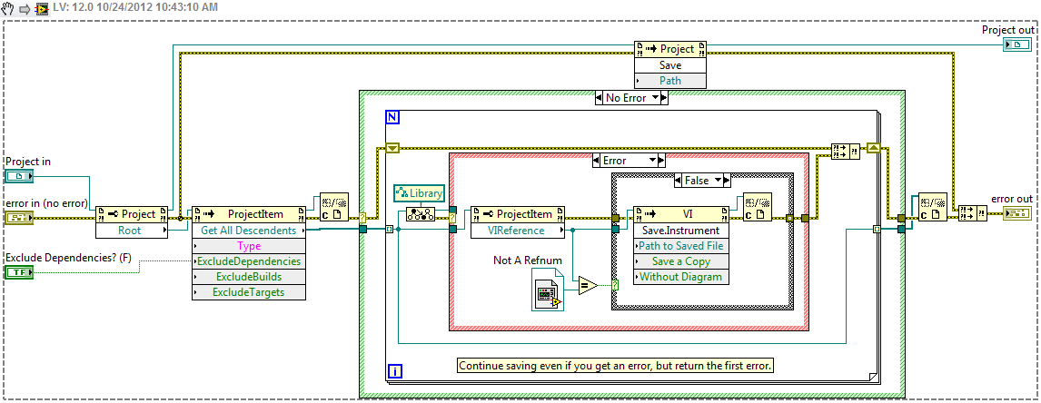

After some more thought....
A few edits to the referenced code.
  • changed error merging to outside the loop
  • migrated Not A refnum and library VI server constants
  • Wired error through all cases (No more look-ups for the default error cluster def inside a loop)
Should speed it up by some (Try it and post results if you can)
A "(VI,Library)" wired to the project Item type filter may also help by reducing the size of the auto indexed array.  but the Help is unclear as to how to get multiple filtered types.  I would need to play with it some
