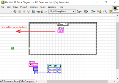

Hello, I have to programmatically move a control out of a case structure, when i try it, it makes the case structre bigger and keeps the control inside. Would be great if someone could help me fixing this, if it is possible.
Here is a pic of my test vi blockdiagramm.

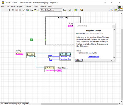

Thank you very much for the fast answer, sadly the Owner property is read-only, is there another way to change the owner?

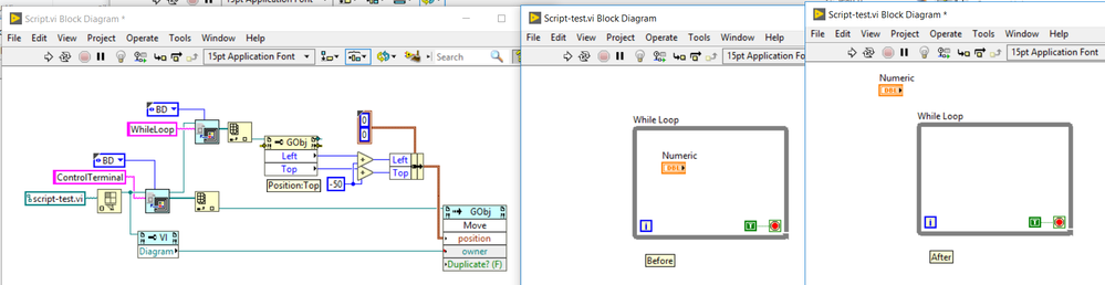

So: You cannot change owner from the same VI that runs, you must edit an inactive VI.
The function you missed is Invoke node - Move. That both moves and changes owner.

Then i found the Move-command. That solves a lot. 🙂
