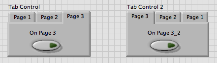

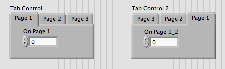

Is this what you want?

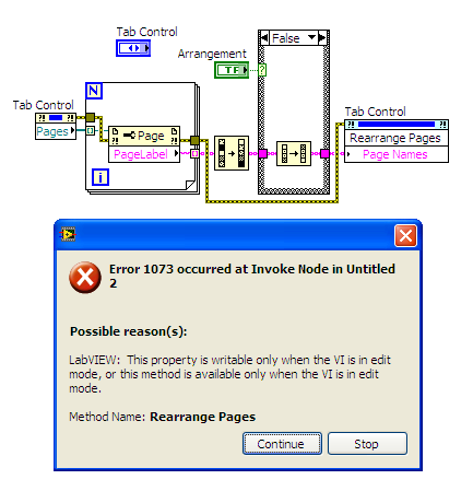

RATS!  I should have looked at the help...
