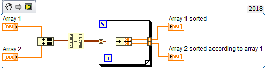

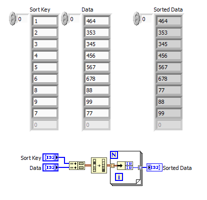

Yes, that's easily possible. What have you tried?
(2,628 Views)
Accepted by topic author PULSE.Wannabe
(2,625 Views)
ah I never use index and bundle cluster array, I didn't concatenate them because I thought it will also sort the 2nd array.
thanks !
(2,529 Views)
Arrays of cluster will sort by cluster order. The values of the second element are only relevant where there are duplicates in the first value.
