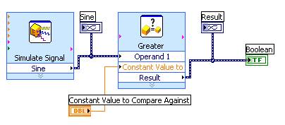

Sammy,
I see what you mean now.  I couldn't execute your VI, but I recreated something similar that I think replicates your problem.  I am simulating a sine wave, and then testing to see if the value is above a certain point, which is similar to part of your application.  I would recommend recreating something similar to what is shown below.
If you do code this, you will notice that your signal is close to the Sine graph and what you are seeing on the HTML is what is on the Result graph.  Also I was only able to get the boolean to turn on unless the entire Result Graph is zero.  So for your application, you would want to wire whatever wire is going to the Filtered Graph to the HTML report instead of what is coming out of the Compare Express VI.
Hope this helps!
Andy F.
Message Edited by Andy F. on 02-02-2006 04:34 PM
