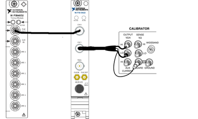

For a calibration routine I made myself pictures and show them before the routine starts 🙂
If a counter input is choosen in the setup, the device is known. Using the hardware node (system configuration) you can optain all information needed.
Here is an example... frontpanels copied quick&dirty copied from the manuals ..
Greetings from Germany
Henrik
