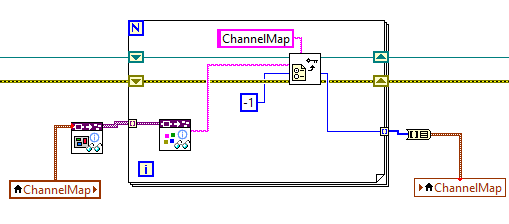

Thanks, yes, that is correct, I want to read each cluster value from an ini file according to name, and therefore need the names as strings.
With Yamaeda's solution, my code now looks like the picture.

True.
All the cluster values need to be of the same type, and in my code I must also make sure that the type of the default constant (-1) that I give to the Read Key.vi is of that same type. Not flexible. I'm sure your library is better. I'll try that out, I'm just working quickly to finish my current development iteration to get it deployed in the field, then I'll check our library out and substitute with more flexible code.

Now your cluster is fixed size, due to Array to Cluster, and although it should work for now it can become a problem if the Channel Map changes size. A small tweak you can do is to 'reverse' the operations you start with, so after reading the ini-file (shouldn't it be a double?) you can convert it to a variant so you build an array of variants, much like you started with, then after the loop you can use Variant to Data and convert that array to a Channel Map. That way it should be more general and dynamic. 🙂

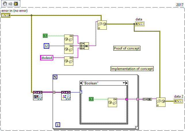

True, you have to use Flatten/Unflatten to string for that. That's how I've made my general recursive 'write cluster as ini'-file. 🙂
It works like this:
/Y
