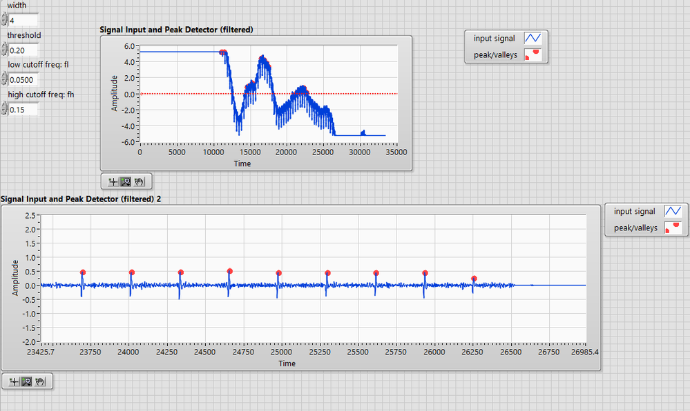

I noticed that with a filter I can adjust the sample rate of the signal. I attached here the vi, you can see what my code looks like

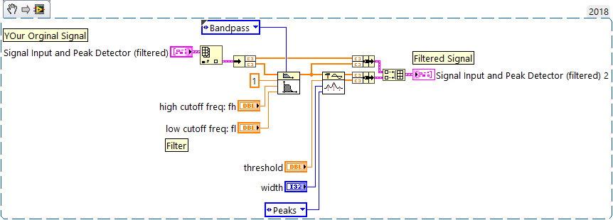

You need to do some signal processing on your input to remove stuff/noise, low frequency drifts, etc. Here is an idea to try, not sure how well it works, but it may point you in the right/wrong direction.
mcduff
