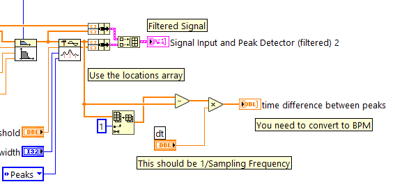

Mcduff, I think my vi does the same thing as yours.. I tried to apply what you told me and this is what I get..

Not sure what you are asking. Your frequencies are off from real values, because you have a dt of 1 in your data.

Mmm true... but I need that dt to show the location in time of the peaks!

So, do a conversion from a dt of 1 to the real dt. Then peaks will be in real time and you can convert.

Did you figure it out yet? You can try adding this to your analysis.

Hello mcduff, my code does the same as your analysis, my dt isn't 1 but 0.0006 (I checked it with an indicator).
My problem seems to be that I'm not filtering in the right way.

If I use a dt of 0.0006 I get a ~5 Hz rate between beats, much too fast for a heart beat, but is this a simulation.
