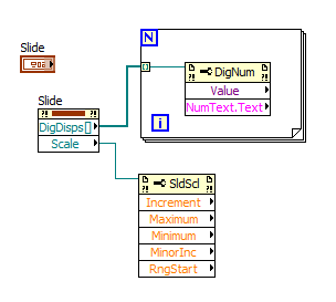

Is there a reference to a Slide control's Scale Maximum or Minimum available? There are references for the Digital Displays of a slide control available to programmatically have control over Value, NumText etc. A user can modify the Slide control's Scale Maximum or Minimum in the same way after having selected them by editing or typing a new value. Therefore I wondered whether there are references available for these Min and Max "controls", as I need to programmatically have control over user entries for these two fields. (The reason behind is the same explained in this post.) I can't see the desired references in the properties list, I wondered whether there's some hidden or for me unknown way to get them... Thanks for any help!

You can set these property nodes to "write" (right-click...) so you can programmatically write new values (instead what you currently do: red the value).

Thank you altenbach for your reply. The thing is unfortunately a bit more sophisticated, I really need the references, it's not just the value I want to write. The printscreen with the property nodes I posted is probably a bit misleading, I posted them only to show where I searched for the references in the properties of the slide control's property node.

You need to type it to  more specific class. Then the property references associated with a slide are available.

Hi chrylarson, on your printscreen I don't see what reference is coming from the left, I guess you're wiring it from the Event terminal "CtlRef" of the "Slide": Key Down? Event. If yes then a to more specific is not needed I think...
Finally on your Slide property node are visible the references for Label, Caption and Scale, I was searching for the Scale Minimum and Maximum references. But you inspired me to check another time everything that is available, and I found the Markers reference. (Markers, belonging the "Text" class.) A bit special seems to me, that there is only one reference available. I would have expected two references of Digital class. In the attached modified example vi you can see and test it. Wiring that Marker reference to the Event terminal "FocusObj" when not having the KeyFocus on the Digital Displays, makes all in the example vi used Events work as expected. Magic!!! It seems the Scale.Marker reference is automatically the active one.
