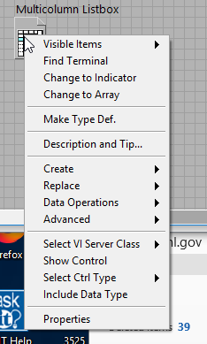

Before your Test Setting Default and Limits vi, you combine your references into an array. You may notice some dots on that array, you are coercing those references to generic references. You need to go back to specific reference so you have two options:
  1. In you settings subVI, right-click the DigNum Reference and uncheck "include data type".
  2. Use Type Cast to convert to a strict type for each reference.
Choice 1 is much easier, choice 2 you need to make a case for each kind of reference, once I did choice 1 your VI works.

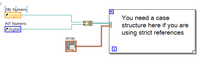

Remove the typecast in your diagram, not needed if you remove data type. The beauty of removing the data type is that you no longer need a polymorphic VI, one subVI to rule them all, that is, it will work for any numeric data type.
Type cast would be used if and only if you want to keep "strict" references. So the reference on the type cast would have to include the data type. Then you would need a polymorphic subVI and choose the correct instance in a loop.
Not including the data type is a lot simpler and easier to maintain.

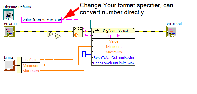

I think you can do this to get rid of the decimal point, and it should also work with the integer case. I would include the rounding. This should work for a generic reference, that is, one that does not include the data type.
mcduff

If you go down the route of going to a more specific class, then your "For loop" in one of the VIs that you uploaded would need a case structure in the loop in order to pick the correct class.
Someone wise on these forums says, "do more with less code." I suggest you follow that advice.
mcduff
