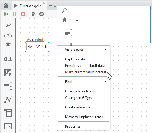

The function should be located in almost the same place as it currently exists in LabVIEW. Right click your control > Make Current Values Default. I am using LabVIEW NXG 3.1.1 and here's how it looks like:
Programatically setting them (via Invoke Nodes) is not available yet.
