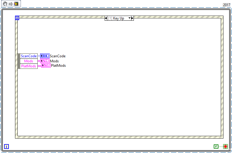

Here is an example:
Look at the scan code
Tim

wiebe@CARYA wrote:
The problem with the "other VIs" is probably that they only look at the char value of the event. You need to consider the VKey.
Or scan code...

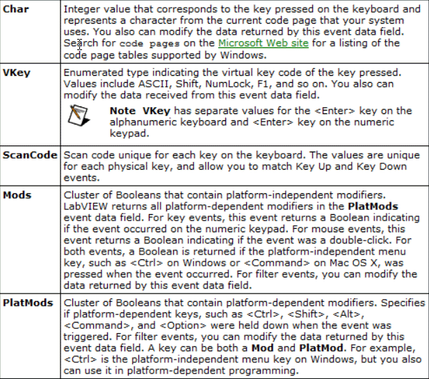

Well, the KeyDown field in the LabVIEW Event structure (present for at least as long as I've been using LabVIEW) provides a lot of data (some of which you might need to look up/research):
Bob Schor

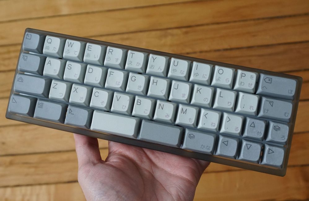

Keyboards such as this. 🙂
