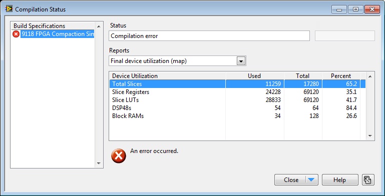

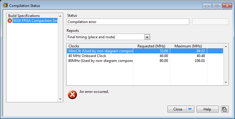

Well, not great news. I set the flag, started LabVIEW 2012, loaded the Project and started a compile and it still fails. What I don't undersatnd though is why. The Device Utilization report shows that nothing is at or near 100%, and the Timing report shows that everything can run within the clock requirements. So why did it fail? I've attached the Xilinx log, which seems to end with a positive "Generate Programming File completed successfully" message.

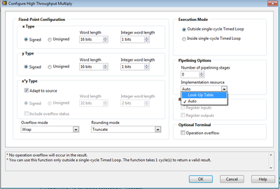

What modules do you have in slots 7 and 8? I'm guessing they're the same? Basically, the interface to those modules is failing timing. You may have to turn off the ini Token (it does say that timing performance may be degraded in that KB). Does manually setting the HT Multiply's pipelining options to LUTs help?
Cheers!
TJ G
Message 14 of 37
(2,514 Views)
To clarify, set the implementation to LUTs, and remove the ini token.

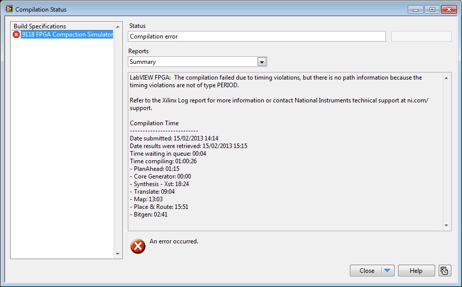

It still fails to compile. Same error details in the Summary view of the Compilation Status window. The Xilinx Log is attached again.
It shows the same errors, so this means they are not related to the LabVIEW token I removed.

Does this indicate that the reason this isn't compiling in 2012 (or 2011 and 2010) is because of timing violations on the single axis servo drive interface modules?
To test this I'm cloning the FPGA code and stripping out everything unrelated to these two modules. Let's see what occurs when it's compiled...
