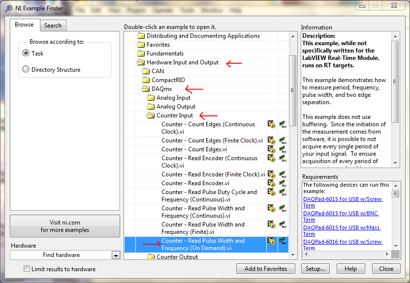

Hi Aleksi,
Well, you don't have to worry about building basic DAQ functions from scatch. There is already an example code in LabVIEW, where the codes for frequency measurement are already done for you.
All you need is to go to Help > Find Example, and look for the following example VI as shown in the diagram below:
I'm still trying to figure out the reason why the response is slow using DAQ Assistant.
