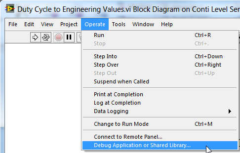

Do you mean to debug your LabVIEW code running on a Real Time system? You don't debug LabVIEW RT applications like you would with code running on a microcontroller.
You need to enable debugging in the RT application and enable VI server access, but then you can connect to the running application to debug it here:
