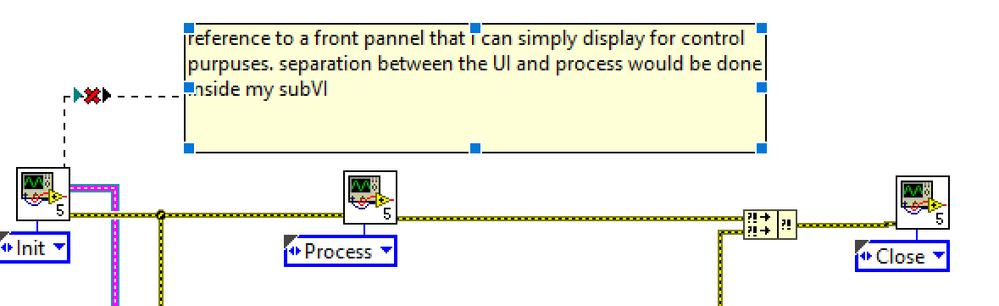

I'm getting quite close now by creating an AE for a subsystem so I can first initialize it, once this done I can get references from notifier/queue for the display/data-logging/... and It would make sense to get a reference to the control so I can use it from the Main VI.
For now I could get a reference to a control inside the subVi, now I would like to display the control in my Main VI in order to drive the subVI without creating a loop and some logics. so If my subVI changes, I automatically get the right front panel associated.
I actually find very strange that this doesn't seem to be a common problem. but for me decoupling parts of the system should be an important matter... and the subsystem should be able to have a way to define its own front panel.

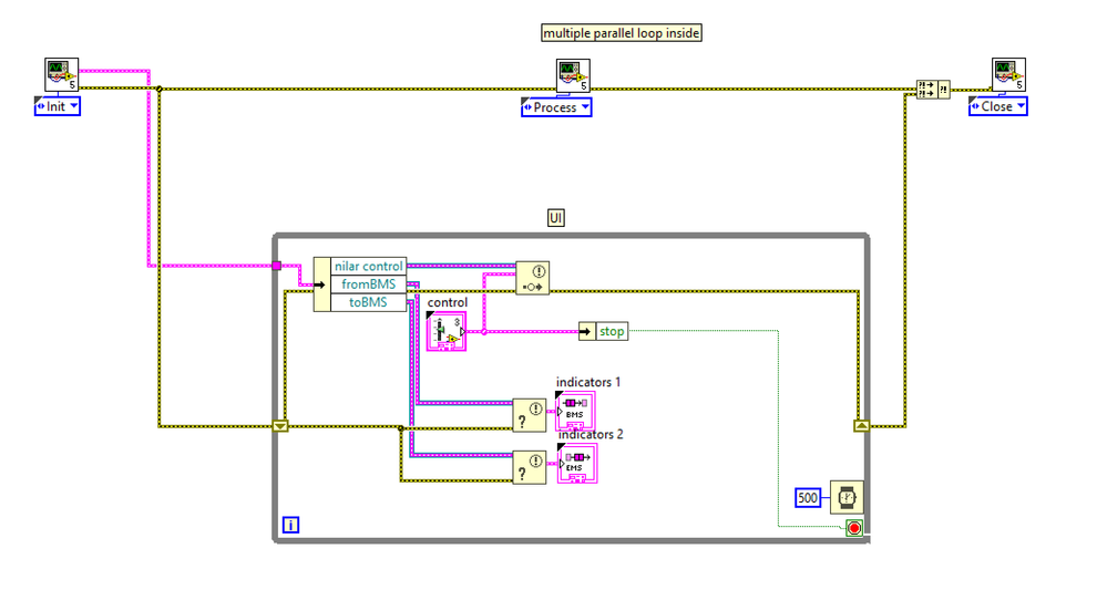

So, this is my result so far :
This is not too bad, but I would have really enjoyed no having to put this loop in the main for all my subsystems. but maybe want to simplify it too much and it it just not possible.
At least the controls and indicator are not defined in the main but as typedefs in my subsystem.
The only problem here would be migrating every subsystem to this principle: it will not be an easy task.
edit:
I put the send notification in an event structure, should be more efficient to avoid polling.
A good thing would be to avoid polling for receiving from the subVI but I don't see how yet
