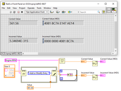

I have been wanting make use of the new Maps datatype but I may have run into an apparent bug when running on a sbRIO 9637.
I have a very basic Map with a String Key and a Double Value. When I try to convert my Map to an Array using a For Loop, the result is an incorrect value. When I inspect the flattened string, the bytes appear to be out of order and some missing.
This behavior does not exist when I use a Single instead of Double datatype.
I have also tested this on a 9033 cRIO and My Computer targets and they function as expected.
Can anyone else confirm this incorrect behavior on an sbRIO 9637 or any other target?

The problem is that you are not converting it to an array, but to a scalar. Does it work better if you enable indexing at the output? Just curious.
(but yes, I agree there seems to be a bug because your code should work too)
Does the following workaround give the right value?

Your workaround is what I have already implemented as a temporary solution, I had disabled the indexing at the output of my for loop because I was just testing with one element. Turning indexing ON results in the same incorrect value.
Thanks. Good to know. I do have a sbRIO 9637, but I am working from home and it is in use, so I cannot test.
I assume that if the map contains multiple entries and you autoindex, all will be wrong, not just the first one(?)
I'll create an entry in the 2020 bug thread .

Correct, I was just trying to show the issue in its simplest form. Thanks for the help!

It also reproduces on a RaspberryPi 4; I'm guessing it's something unique to the arm architecture.
I'd be curious to see what happens if you try sending the result to the host via some other mechanism, such as a network published shared variable, network stream, etc. It's possible this is "just" a bug with how the interactive ui works and the target side code actually behaves as expected. (Neither of these are supported on a Pi, and I don't have any other arm targets handy,)
Edit: I just did a simple "equals" comparison (which should be valid in this case despite the fact it's a floating point), and the result comes back false. I think this is a legit case of incorrect code behavior.

One more observation... singles work fine but I64s are also wrong. I think it probably has to do with the fact it's a larger than 4 byte numeric datatype.
Also, for some inexplicable reason, an array of doubles (even a single element) seems to work fine.

We've seen this conversation and have reported this as bug #1131063 here at NI. Thanks for helping us make our product better!
