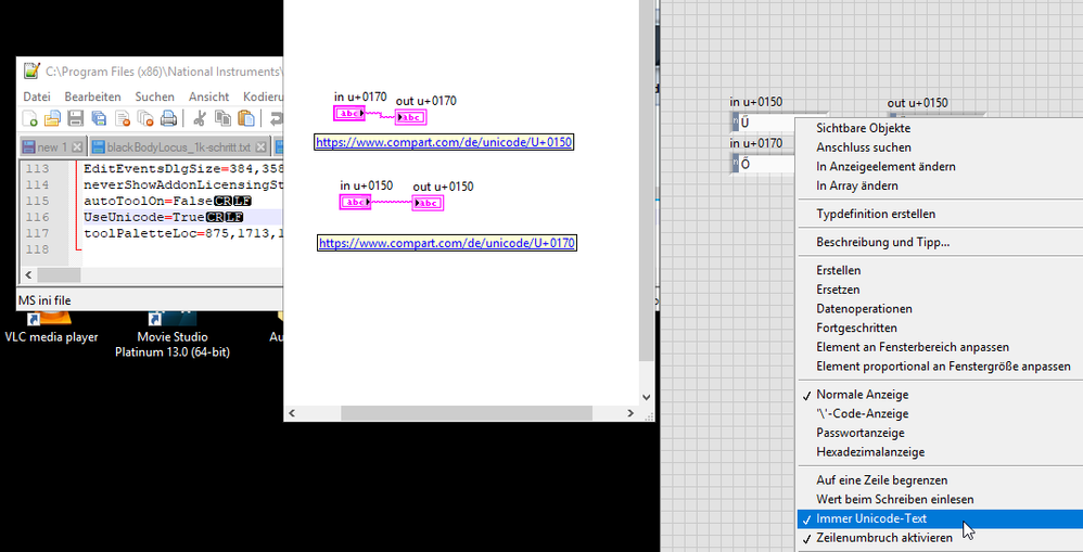

Have you tried to change ist to utf8 before writing it to the DB? If reading it from the DB you have to change it back. For conversion there is a hidden LV function. Have a closer look here:
https://forums.ni.com/t5/LabVIEW/undocumented-function-quot-text-to-utf-8-quot/m-p/1034616/highlight...
Message 6 of 10
(3,942 Views)
This is a cool function if you want to write special characters like Ő as an utf-8 string to a text-file
but does piZviZ's SQL 2008 database accept utf-8, or rather UTF-16 encoded strings?

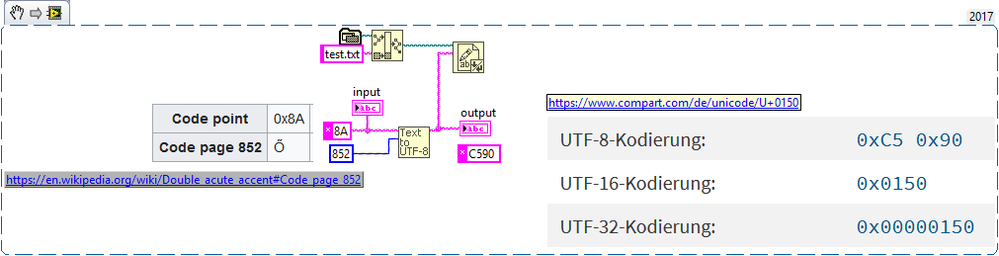

Download is in the link I've sent.
A more detailed description can be found here:
https://forums.ni.com/t5/Reference-Design-Content/LabVIEW-Unicode-Programming-Tools/ta-p/3493021
Message 9 of 10
(3,905 Views)
the LabVIEW Unicode Programming Tools
are a different resource (in regards to undocumented function "text to utf-8").
You could use those Unicode Tools to write an utf-16 string to file via LabView.
also, its a good resource to learn about unicode-specific tidbits (that may bite you) like utf16-LE and BOM
