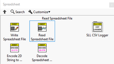

SLL Toolkit's spreadsheet VIs support quoted strings in CSV files,
