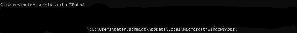

Path variables are setup correctly (installation is under C:\users\peter.schmidt\AppData\Microsoft...). From above you can also see, that I can access python via cmd:
echo %Path%:

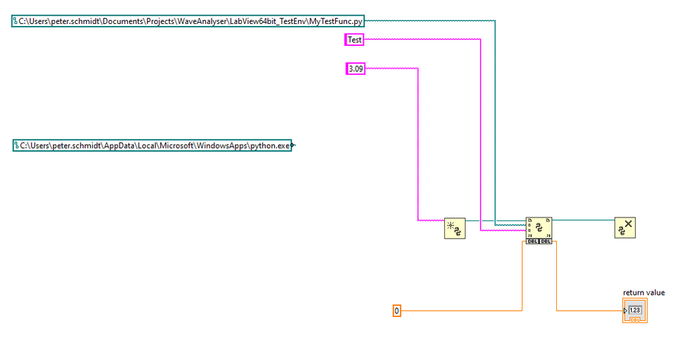

My VI looks as follows:
It just consists of a Python Session On -> Python Node -> Python Session Off. The python code in MyTestFunc.py is:

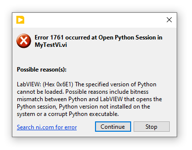

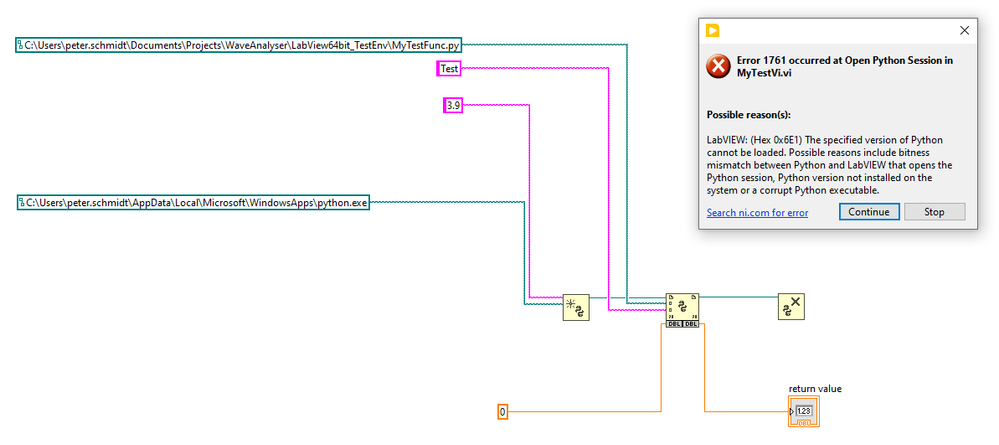

So this simple Test() Function does not take any arguments and just resturns a float constant 2.2. Running this test VI gives me Error 1761:

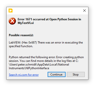

It basically seems that LabVIEW does not find the correct python path. However, if I pipe-in the python path, by connecting the string constant (e.g. C:\Users\peter.schmidt\AppData\Local\Microsoft\WindowsApps\python.exe) with the Open Python Session INPUT for python Path:
I will receive Error 1671:

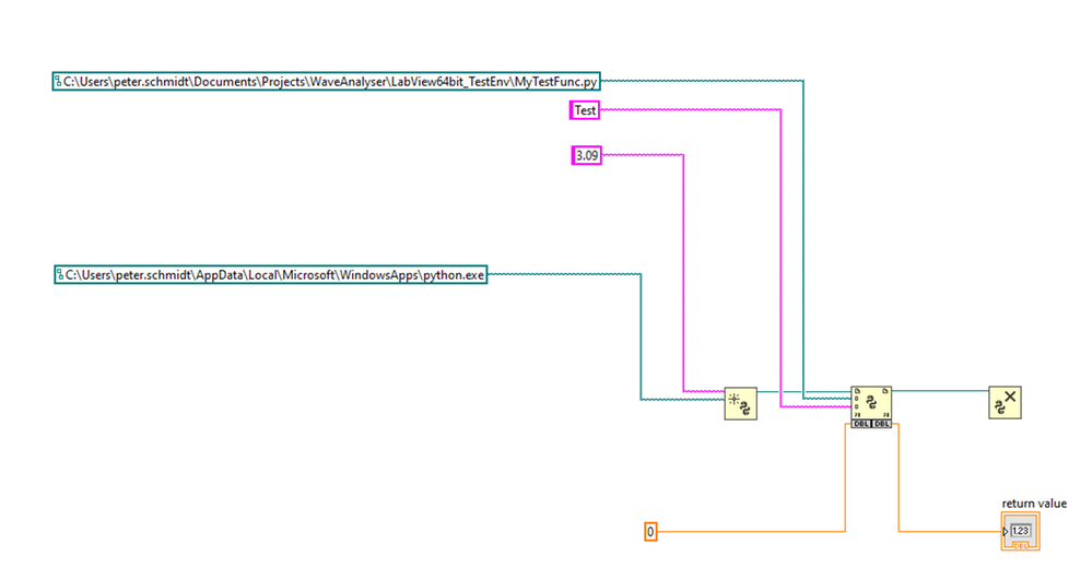

there is an error in you python version string, it should be 3.9 and NOT 3.09
(12,399 Views)
Many thanks for the reply! Shame on me, you are right! Unfortunately, that does not fully resolve the issue. With the correct version string, 3.9, I still run into errors:
If I keep the python Path connected, I will receive Error 1761 now:

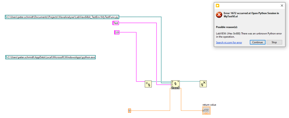

If I disconnect, e.g. let LabVIEW choose the python path by system path, then I now receive a new Error 1672:

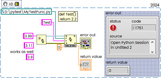

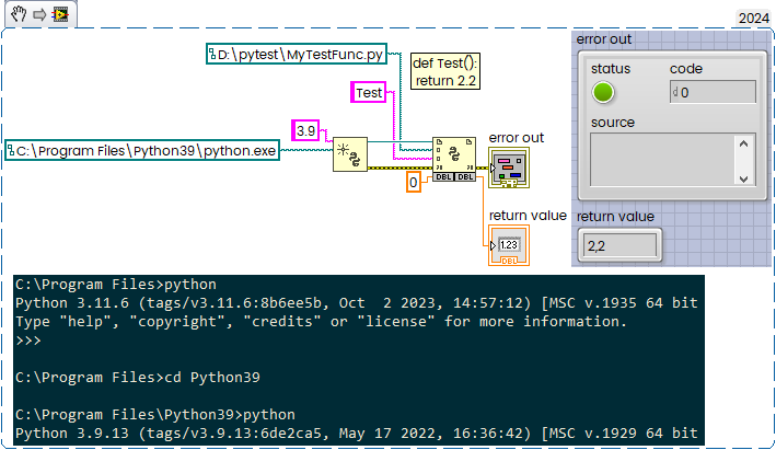

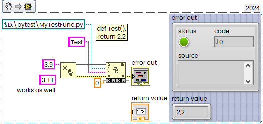

For me it works in this combination and take a note I have default python in PATH 3.11.6, but 3.9.13 also installed and it works:
and also if I'll disconnect full path to python, still working (kind of magic):
only with wrong version raised error 1761:
But I never ever used installation from Microsoft Store. Try to download and install python "normally" from original website.
