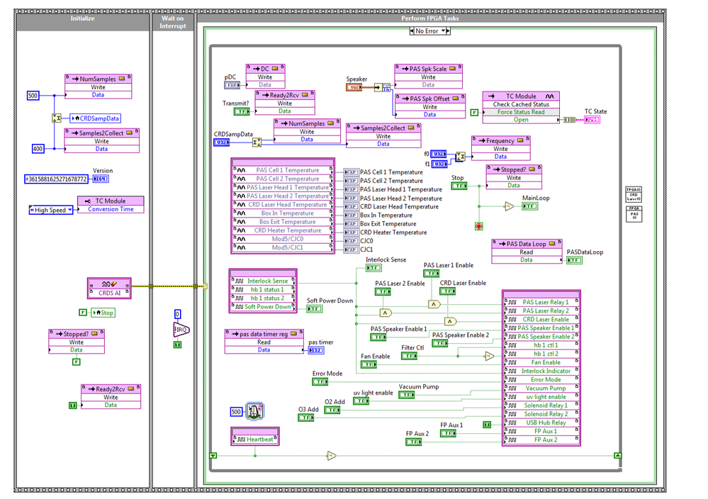

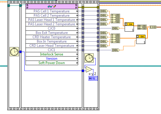

I seem to be having an issue with sampling from the TC-9212 using the cRIO.  The issue I believe is on the client side.  I am sampling from the 9212 and am trying to take measurements at 1 Hz using the following code in the image:
Simple enough.  But, for whatever reason, attempting to read the data from these FPGA controls is taking over 1.5 s.  Does anyone have any thought as to why this might happen?

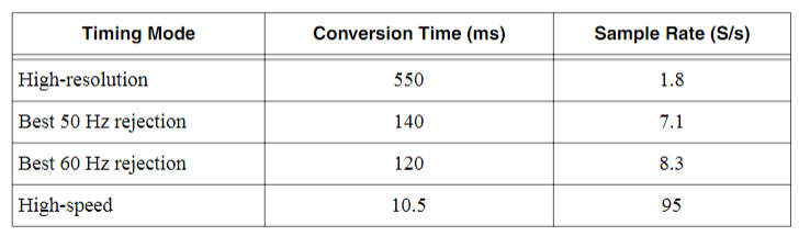

Hi cirrusio,
which of these timing modes do you use?
Screenshot-2017-12-19 NI 9212 Datasheet - National Instruments - 374358b_02 pdf.png
How do you read all those channels in the FPGA?

Thanks, guys.  I am using the high speed conversion time on the TC module - but this really should not be the issue as I am just reading the front panel values.  On the FPGA, the temperatures are just read off of a single node at 2 Hz.
@crossrulz - I can not (and likely would not even if I could) the scan engine.  I am using a lot of resources on the cRIO that are not scan based.  And beside, why would you use the scan engine when you have an FPGA ;)?

Hi cirrusio,
Then you should show more than just an image of your host VI block diagram!

if not does anyone have a possible alternative explanation.  In the interest of transparency I will go ahead and posit a possible alternative explanation - the FPGA resource is getting bound up in another process and this VI is waiting for access.  I don't know if this is reasonable
I don't think your assumption is reasonable: the FPGA ensures fixed execution times as the code is executed by hardware (fabric and gates)!
My explanation: you have one big loop doing all different kind of HW access, including reading measurement signals AND executing property nodes of the VERY SAME module. I guess this will lead to "stalls" in the execution, even when there is just "gates and fabric"!
- I use to put seperate "tasks" into separate loops on the FPGA: do DIO stuff in one loop, do AI stuff in one loop, to AO/Pt100/thermocouple stuff in their own loops. Especially do property nodes stuff in separate loops - only on request, not with each iteration!
- I would also stuff all/most of those boolean controls into just one U16 or U32 value: much less communication overhead between FPGA and RT host…
- On the RT host side I would also break up reading FPGA values into separate loops when I know the FPGA handles those different values in different loops at different rates…
What is this comment referring to?  Execution of what? The FPGA?  If so, please look at the diagram and tell me where the "one big loop" is that you are referring to?  This application uses the native clock which is executing at 40 MHz.  Each of the operations within that loop should be able to execute within a single cycle.  The loop timer for that large loop is set to 2 Hz!  The reason for that "big loop" is that all of those operations are required to execute at very low rates (they are general housekeeping) and I have never had an issue with loop execution not completing within the requested period for these kind of operations.  If this is a problem, then it is related to the TC module specifically.  But, laying all of that aside, the FPGA execution rate on the loop should have no bearing on the execution on the RT side!  The RT side is simply reading latest values and does not have to wait for anything from the FPGA.  That being said, I am adding a timer on that loop to test this.  And, if there is something about how the TC module read is handled that should prevent it from returning at no slower than 1 Hz, please let me know.
We have a different philosophy about this - it is the FPGA.  Yes -a n IO node can take more than 1 cycle to execute, but if you are operating under the assumption that your required execution is low frequency, then this is never a problem.  If I have 40 million cycles to work with, I don't really care if something takes 2 or 5 or 10 cycles to execute. In fact, everything on that diagram can take 20 million cycles to execute - for these operations I don't need the execution speed so I have cycles to spare.
Once again - different philosophy.  I used to be of the same mind, but the truth is this is really just obfuscation and makes the code less clear to read.  You have to ask yourself what you really gain out of this.  The way you are suggesting, I have to first convert an array of booleans to an int and then pass it along.  On the RT side, you have to grab that int, convert it to a boolean array and then figure out which boolean is what.  If you are toggling booleans in multiple places (i.e. your application is distributed) you will have to first convert that int into a bool, then replace an array subset and then convert that array once again to an int for passing back to the FPGA module.  I will go ahead and put forth that, when you have the space, pushing individual named bools in and out is significantly easier to understand than having to assemble and disassemble arrays of bools.  Much easier on the maintainer (even if it is just you a year later).
This is a distributed application using the AF so this occurs naturally.  What I am suggesting above that could be happening is a possible consequence of this architecture.  There are two subVIs on the FPGA diagram, each of which is handling high speed interactions.  Large amounts of data are pushed into FIFOs that are picked up by the DMA on the RT side.  I am retrieving data from those FIFOs at 1 Hz which requires the application to sit on the FIFO reads while it waits for new data.  What is not clear to me is whether something funny could be happening where these reads are blocking access to the FPGA ref (similar to if you had an application trying to access the same VISA session in two places simultaneously).  Given that these reads are executing at 1 Hz, I would expect the ref to become available at at least 1 Hz.  But what if it is not?

Now, onto a real finding
I dropped the number of temperatures that I am reading on the RT side from the 8 channels + the CJC temperatures (2) down to 4 + 1 CJC and found that the the time spent on this FPGA IO node dropped by half (from over 1.5 s to 850 ms).  This timing is specific to that one block as can be seen in the initial image.
