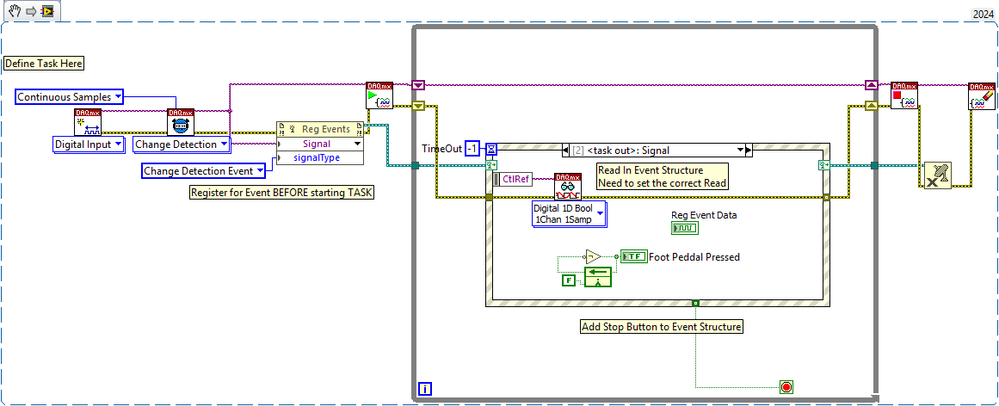

There are some problems with your VI. I don't know how the digital lines are set up as that subVI was missing; so you will need to modify the diagram below to suit your needs. You will have to change the read depending on how you set up the channels.
  1. The Read should occur in the event structure not outside it. The change event is meant for slowly changing data. It is either high or low before the change, reading it continuously is not necessary, only read when there is a change.
  2. You need to register for the event before starting the task.
  3. Close the task and event case properly.
  4. Make an event case for your stop button.
  5. The timeout is useless in your event structure. -1 means no timeout.
(995 Views)
