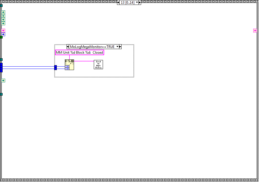

And, as the last thing we do, we de-queue an item from the STOP queue:

The SEND DEBUG thing just formats a string and sends via UDP to a receiver elsewhere.  The sludge behavior happens whether debugging is turned on or not.

Well, lo and behold, there IS an error there - Error 1.
But I never touch that queue, not even to destroy it, except in two places:
1...  When the block starts, I put an element in, when it stops, I take an element out.
2... When I'm checking if eveyone's done.
There's nothing to kill it, as far as I can see.  But yet, it complains of an error 1 (bad parameter).  The only parameter is the RefNum, so somebody is killing the queue.
