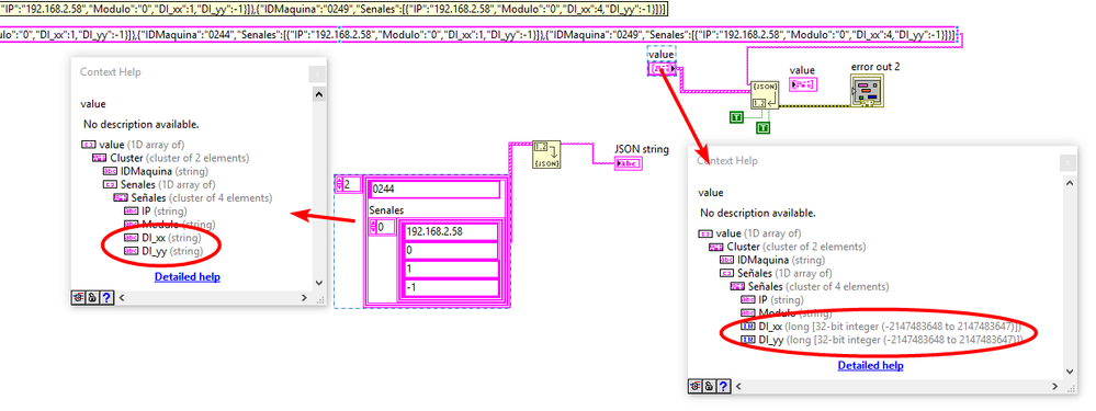

I'm having such a hard time with this little task, decoding a JSON string. I have a data mismatch. Can someone please have a look and give some advise? VI is attached.

Here

You can use this to create a control from a JSON string.

Wow, that's very useful! Thanks alot.

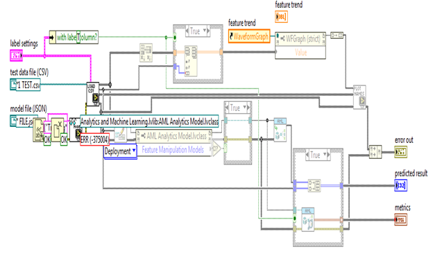

I am also using json file to Deploy a classification model, earlier i trained a SVM classifier with csv file data set by which i get trained model file in JSON  format. now  when i give this json file as input to the classification Deployment, I always show the data mismatch between json & labview(Error Code - 370004, 370005). All the details & data are also attached.370004..png370004.,,,.png

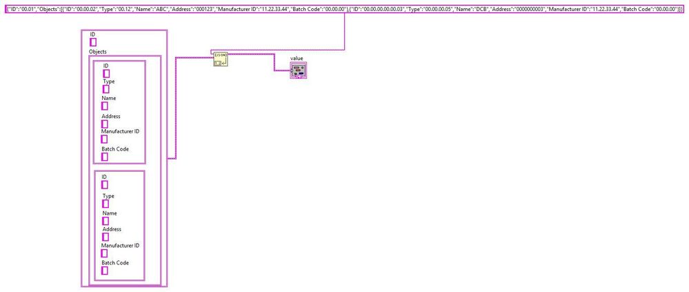

I'm having the same problems with unflattening proccess.
When I flatten a JSon text with a similar structure, the unflattening proccess send me an error.
Can you help me?

Regarding your failing un-flattening: You have two mismatched types:
