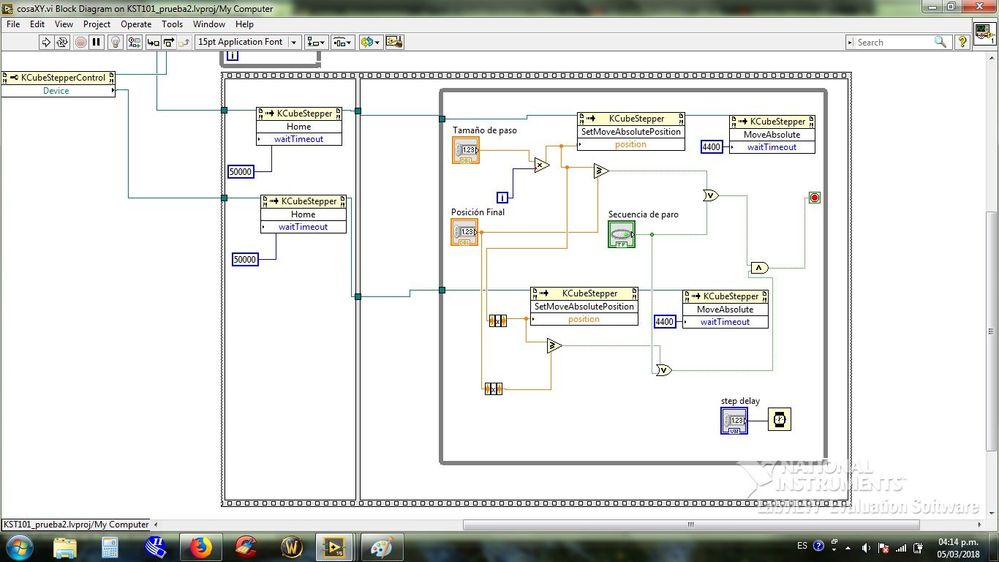

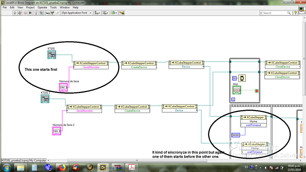

Hi
I've already did that, and the only thing that I can see is that one of the two invoke nodes starts a few moments before the other one, after that, it appears to change when the home operation ends, but then again one starts first. A few time is added on the y=f(x) operation node, but that was something that I already expected because it's a X Y system and the synchronization was the project's final objective.
Also I've noticed that when I use the Kinesis front panel in Labview instead of the Iterative Motion Loop system, both motors can operate at the same time.
So, I'm thinking about adding a little delay, but I don't know if there is any way of adding it to a single wire in specific.
KST101_3.pngSorry about the bad image edition, next time i'm gonna try sending a video, buecause I don't own the controllers and I don't have them right now
In 2017 this is done with the malleable VI (not sure of the name). In older versions, create a small SubVI, with 1 input of wire type, 1 input of time in ms, and 1 output of wire type. Inside the VI wire the input and output of "wire type" together. Wire the time in ms to the Wait (ms) function.
You could also do this with a flat sequence structure representing the boundaries of the SubVI, but I think the SubVI looks nicer.
Message 8 of 14
(5,701 Views)
Instead of using "MoveAbsolute", just use "MoveTo".  I've tested it on my units and it moved them at the same time. I don't have them at my desk to double check that they don't to that with "MoveAbsolute", though.
Alternately, you may have to set the timeout to zero and then use the MotorStateUpdate event to determine when the motion is done (whenever the motors return to an "Idle" state).
