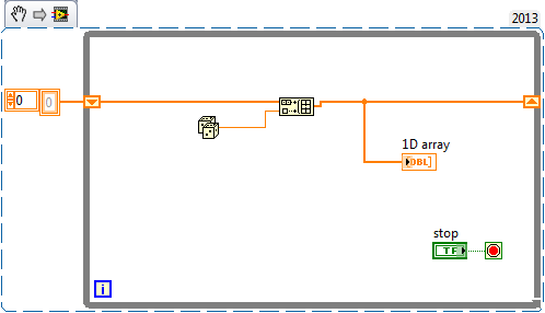

Here is the code for solutions suggested by Christian and Dennis.
In Dennis's solution you will get array after stoping while loop. But in Christian solution you are able to see array if while loop in tunning also.Solution1.png
