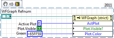

Basically its a number (three bytes which represent a colour in RGB), just wire a numeric constant.
For example green is
0x65FF59
