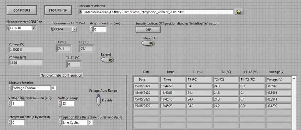

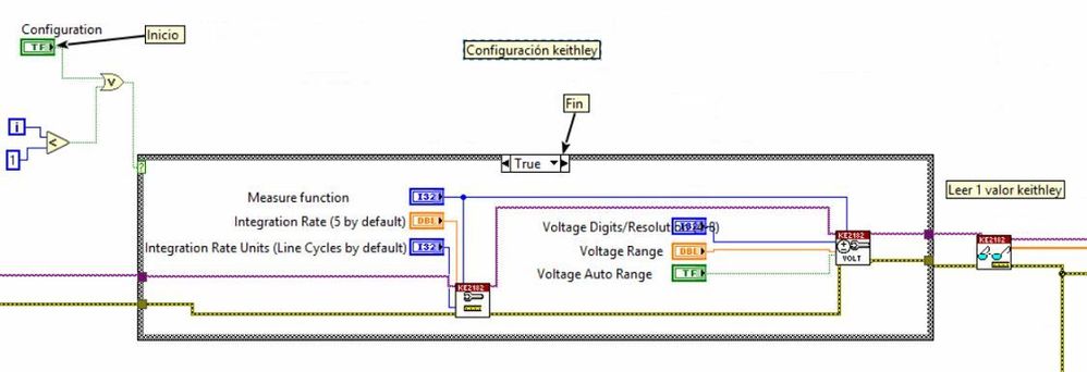

I am developing a LabVIEW program in which I measure voltages with the Keithley 2182. When I remotely implement my configuration (voltage digits and voltage range, f.i.), the apparatus quickly goes back to the default one. Why can be this be caused? Am I missing or not applying correctly some function? I attach a screenshot of the block diagram and front panel to show how my program was designed.

Here is the vi in which my question was based.

Hi Adrian,
please clean up this VI before any further steps…
THINK DATAFLOW:
  1. The initialization VIs are called when the inner while loop starts its first iteration.
  2. The inner while loop starts for each new iteration of the outer while loop.
  3. The outer while loop starts a new iteration when the inner loop has finished.
  4. The inner loop finishes on either Stop button or an error of device communication.
So please debug using probes: are there communication errors? Are the Init VIs called again and again?
Example for possible cleanups:
The conversion belongs into a subVI, and there should be error handling in case the communication went wrong…
I would split up the whole VI into atleast 3 parallel running loops, with each device handled in it's own loop.
By using notifiers (or tag channels) you can use subVIs to simplify the mainVI, no need to use locals for data transfer.
Do you really need to multpliy with 1e6 to scale from Volt to mV?
Do you really need to read the data file in each iteration to display some data? You should atleast use DATAFLOW to avoid parallel file access (with possible errors!):

Following the previous message, I deleted the outer loop and kept only the operation for the Keithley for simplifying the operation.
I have seen that when I select "Configuration", the configuration for the voltage digits works but for enabling "autorange" or selecting "Voltage Channel" it does not respond. Looking at the Keithley display, I have seen it changes for a small fraction of time and then goes back to the default option.
Can anyone help me to determine why is the VI (included in this message) working for voltage digits but not for the other options?
