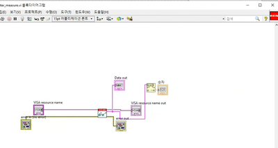

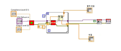

This is the whole VI,
I used sub VI a lot because I need to use in another code.

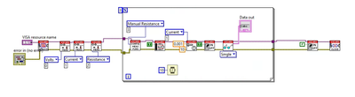

Not sure if this will help but here is the pertinent part pulled from one of our routines.  I don't see anything obvious for order of operation that would cause yours to not work, but I don't have direct access to the hardware currently to test it out.

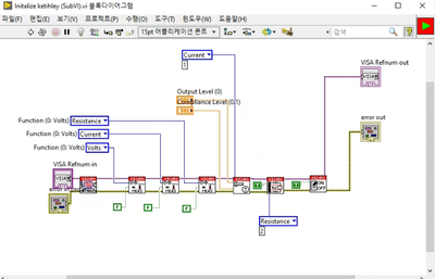

thanks for reply.
I build this VI again, but it gives
2 wire mode, resistance measurement, input voltage.
I have no idea what sub VI can set 4 wire mode...
Did I miss something?
I found that if I do in this sequence, it can measure
input current / 4 wire voltage measurement mode / voltage output
when I use Keithley program to measure sheet resistance, it measure resistance using 4 wire voltage measurement mode.
So I guess using 4 wire voltage measurement mode is right, but I don't know how to make output as resistance ( ohm unit )..
Do you have any solution for this..?
