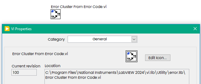

Very strange, this is standard LabVIEW's VI, usually located in vi.lib\Utility\error.llb\Error Cluster From Error Code.vi
try to relink manually if LabVIEW unable to locate it automatically on open
