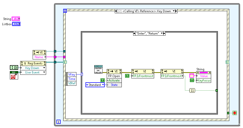

I'm having troubles get key focus on a control in a subvi that I am showing dynamically. I'd like to be able to leave the VI running in the background, registered for events on its caller. In this example, I have the subvi registering for events when the user preses "Enter"/"Return" on its parent. Then, I am programmatically showing the subvi's front panel, and attempting to set key focus for a string control on the FP:
Everything is working properly, except I can't for the life of me get this subvi to move to the front and give keyfocus to the "String" control. Originally, I just had the FP.Open method followed by the value/keyfocus property nodes, thinking that would be sufficient. Later, I found a KB suggesting that I might need to add the FP.IsFrontmost property. But it still doesn't seem to work.
The probe #11 as showin in this capture always returns FALSE, despite showing no upstream error when I set the FP.IsFrontmost property immediately beforehand.
I've tried introducing waits and moving the operations to separate dynamic user event cases; still no joy.
Am I missing something dumb here, or is there some apocryphal magic incantation that needs to happen to get LV to accept my frontmost/keyfocus assertions?

Shortly after posting, I found the problem:
I needed to change the WindowBehavior of the subvi from "Floating" to "Default", and then it started working correctly. I guess "Floating" behavior doesn't play nice with those properties/methods, although I can't come up with a good explanation as to why.
