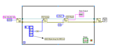

Hello All,
May be this might help to understand better with Block diagram.
Cheers
