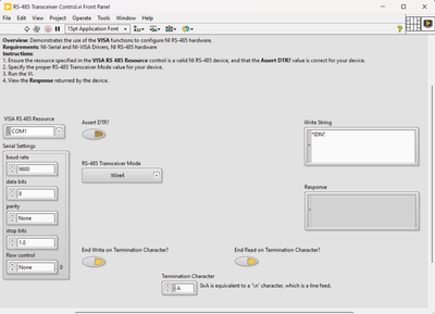

Hi! Thanks for asking so fast. Here I'm going to leave you the code, I know that is easy because I'm learning labview but it should work. I also leave some images of other easier code that I tried.
ps: I tried to use the example from labview but I got the following error:
Thanks and I'll wait your response 🙂

Ensure LabVIEW recognizes the DTECH USB 2.0 to RS422/RS485 wire as a Visa device .
Check the Speed and configuration as suggested.
Before going into LabVIEW, use NI Visa Interactive controll to send commands to the device and see that it responds back. Once you tested that the communication is working, then try running the example from LabVIEW.

It times out because is waiting to read 1024 bytes. The device is responding 13.
Message 7 of 11
(1,414 Views)
It also says that you need a CR.

OMG it was a problem of the DTECH. For everyone who wants to try with other solution for the KJ lesker 354 this is better https://www.digikey.com/en/products/detail/display-visions/EA-9790-USB485/22119716?gad_source=1&gad_...
