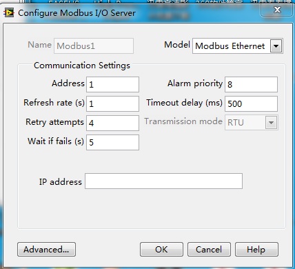

LABVIEW DSC module connect to modbus
May i ask a question about DSC Module connected to modbus
For  the DSC Module that i can create Modbus IO sever and then create varible to connected to modbus through Earthnet.
But how can i define the varible address according to modbus address.
For example i want to use 03H coil to read address 4 data. How can i define 03H coil in the labview varible address list.

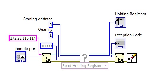

Hi Smithed
  Glad to receive your reply. I once read this help document before but still have some confusing about it.  What i want to read the modbus address is" The function coil is 03 and the address is 06H" . This function that i can achieve it by modbus library(read holding register.vi) read input . But i do not know how to achieve it by bound varible.
  First what is the address meaning? type 06?
And how can i chose the boundary address. For the name of description that i choose "400001–465535 "(Holding register). But how can i define it? that i will define 400006. but follow that setup that i can not read what i want?
So may i ask how can i to define them that follow my previous description.

With DSC 2014 release, you can choose to use Modbus LabVIEW APIs on the palette. Have you tried that?
