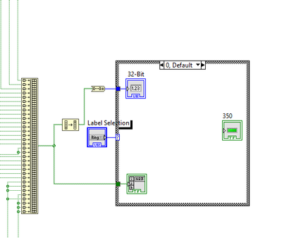

Hello guys! I was trying to figure out how to have an LED light up only when I select an option from a dropdown ring. Each option would have its own LED and would like them to light up the same way. I tried searching with no luck. Thanks for the help ahead of time!

Hi Guy,
All you need to do now is to wire a TRUE to your boolean indicator "350" as you already use a case structure to handle the "option item from dropdown ring"…
What exactly means "light up"?
So you will have several cases in your case structure!?

I have wired a TRUE to the 350 and it does light up, however when I select a different case from the dropdown I would like it to stop being on ie, be FALSE.
By light up I meant that the LED looks like it is on.
Yes, I have multiple cases and would like an LED for each case.

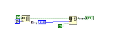

I"m not sure if I understood your question.
Would an array of booleans work for you or you need individual leds ?
Message 4 of 8
(3,212 Views)

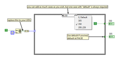

So I would have an single LED for each case like 350 and 305 in this image. When I select a case, I would like its LED to light up and all other case LEDs turn off
Message 5 of 8
(3,207 Views)
Hi Guy,
Then all those LEDs (305, 350, ...) belong AFTER the case structure!
You only need to wire a True/False constant inside each case to the LED indicators…
THINK DATAFLOW: each case wants to write a value to all those LED indicators so the common part (of writing to the LEDs) belongs after the case structure. Inside the individual cases only case-specific work needs to be done (like selecting the True/False values)!

I have tried the TRUE/FALSE constants but my issue was that when I switch to another case, the LED does not turn off.
Message 7 of 8
(3,170 Views)
Hi Guy,
would this be something you are looking for? ExampleVI is attached.
